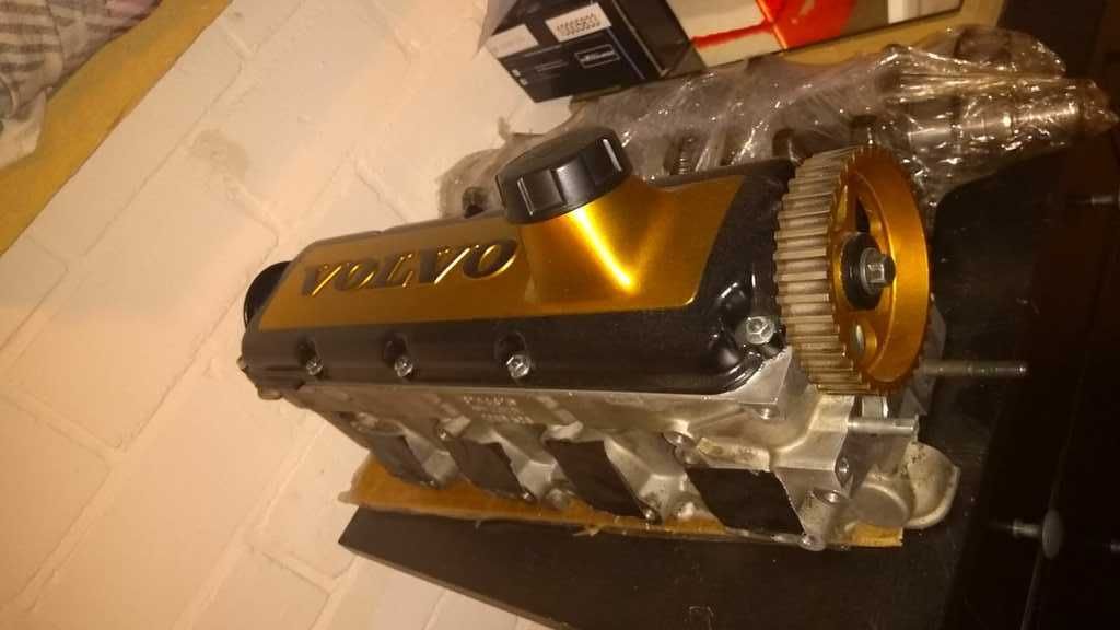

For part 2 of the build, it was time to get into some headwork, I chose to go for a mild port and polish, with cleanup of the valve seat to port area, slightly worked valve guides, a controversial dimple port since the stock volvo injectors which I intend to use in pairs are not really great in terms of atomisation. The head worked was a 530 casting, since this was my first experience porting, and 531's are hard to come by.

Installing KGTrimmning dual valve spring kit with light weight retainers, ready for 7k rpm
Assembled head, ready for installation, only relube and chamber polish required.
