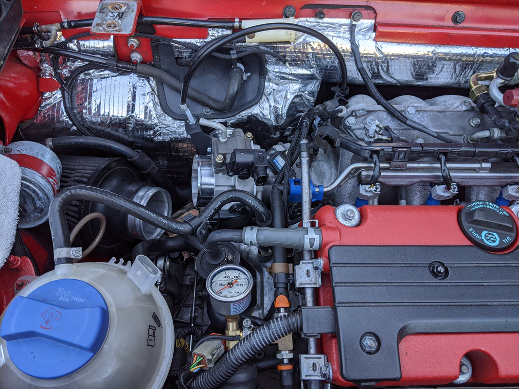

Got the MAP bung figured out. Drilled & tapped the flange to use for the hold-down
Revised the supplied bracket so that it fits the reverse orientation I need
Used the 80mm setup to check offset
Everything looks pretty good
Have to figure out an alternative air filter hose
