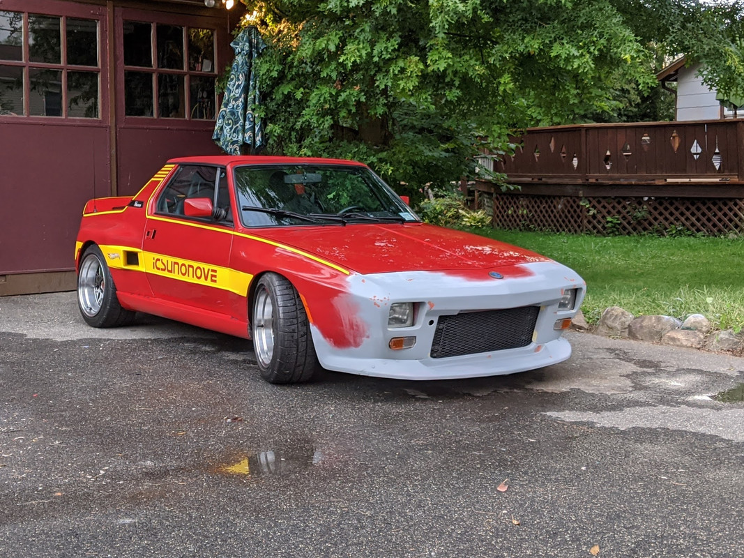

I did take the LH 2.4 conversion as far as I could - it ran very well indeed. Just not enough HP to squeeze out of a 1600 that would be commensurate with the revised body work :D
I didn't alter the footprint of the X1/9 in terms of chassis, suspension & steering specification. Not sure what you mean by the frame sections, exactly. I had to section elements for Honda drivetrain clearance .... I bought the drivetrain (JDM), hard to find a US car that would have had only 60K on it, and the JDM K24 has better spec than the US version.
So, it's still Fiat, just improved upon.
Got it off the jack stands yesterday, gave it a quick wash - it looks pretty good overall. I want to drive it for a couple weeks before I pull the drivetrain & finish the undercarriage repairs.
