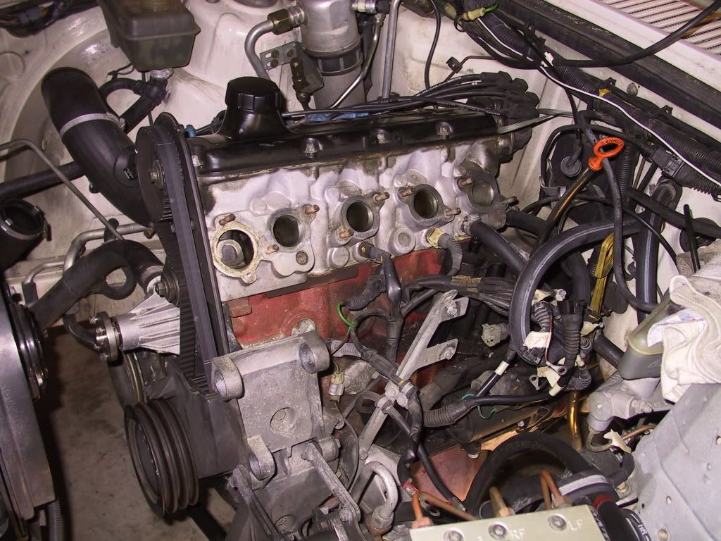

Now then begins the disillusionment, or as the legal folks call it, "the discovery phase". How bad is it? What lurks within this disfunctional beast? So I begin to peel this onion, to find out if my suspicion is correct....and hope that's ALL that is wrong.
So around May of 2010, we begin like this:
