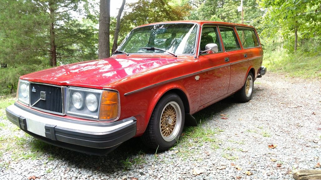

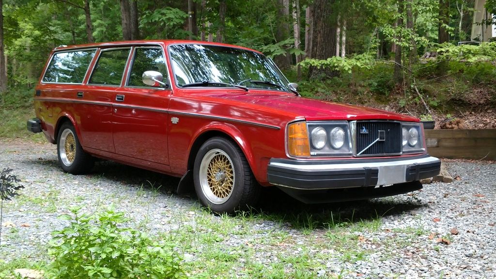

Finally got around to waxing the car, after numerous false starts, including full compound and initial prep.
I powerwashed the flaking clearcoat to clean up the hood. It'll do for now.
Other note: I had a new '91 windshield installed a couple of months back. The old one was pitted and leaking in numerous spots around the perimeter. I like the new one quite a bit, though it comes at the expense of having to remove the chrome trim. I might try to affix the trim to the rubber to get that original look back.
