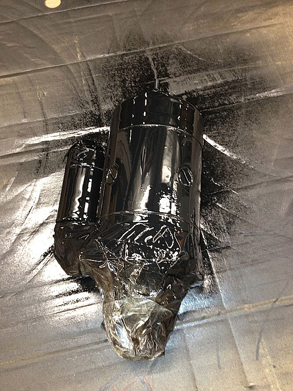

Did some sand blasting and painting myself,
And decided to put the original engine in for the time being so cleaned the engine and did some cosmetic repairs,

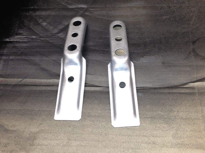

Location: Long Island/Delaware
Originally Posted by Johann View Post
This is an awesome thread so far, I am tempted to paint the brackets the way you did instead of Zinc plating! The silver looks great on the parts, not sure they will look good on my already silver GT restoration though!

Originally Posted by Old Iron View Post
The silver
It isn't really Silver. It's called "Steel wheel". Motip 04010

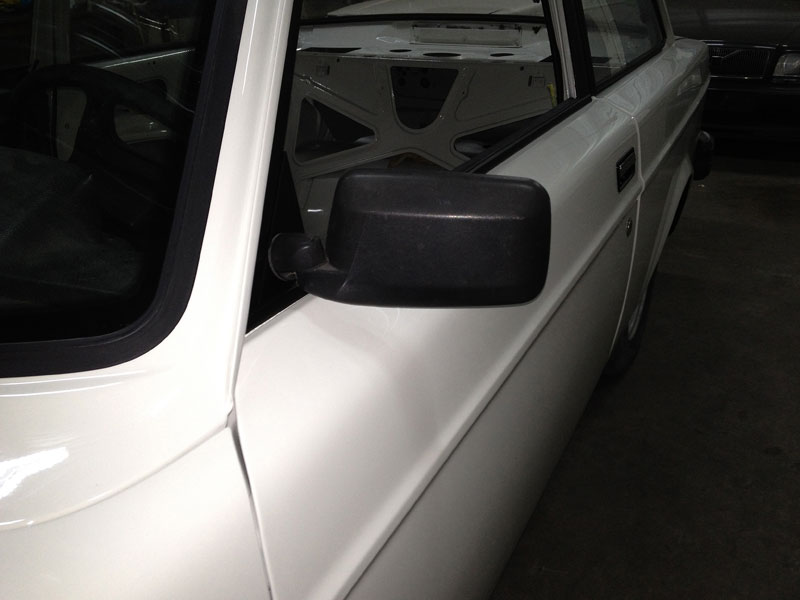

Johann
Johann's Avatar
Join Date: Aug 2006
Still figuring how to paint the mirrors green..

Fit the blockoff plates, run no mirrors, paint the plates green.
I have a plate from a UK car for the other side, maybe I'll install that one this year and just install a convex rearview on the inside.
towerymt is offline   Reply With Quote
Old 01-28-2012, 04:14 AM   #18
Johann
Johann's Avatar
Join Date: Aug 2006
Without at least the driver side mirror the car isn't road legal.
The one thing keeping me from painting it green is that it is a complete mirror instead of just a cap like the 850 and C30. This way it will be all green up to the hinge instead of a black base. I think all green will look goofy.

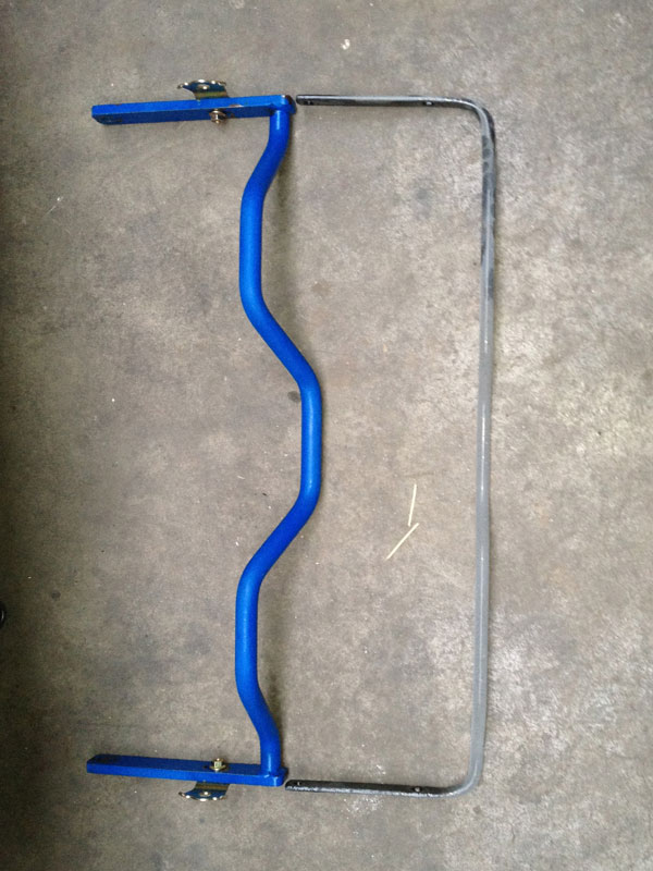

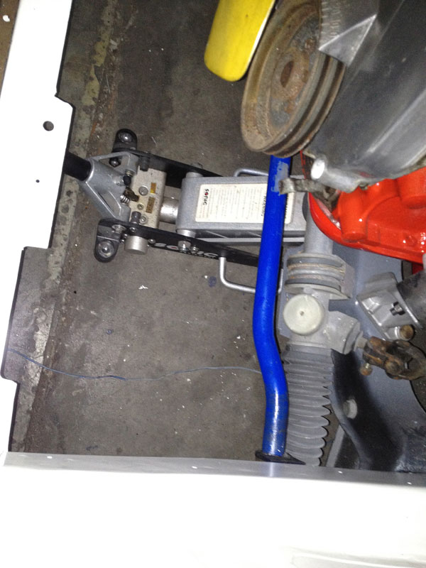

Although a new set on long overdue backorder I managed to get a used IPD sway bar set,
Should be 25/22 although the rear appears bigger. Hollow tube?

Mount the big front, keep the stock rear bar.
Why? To create more oversteer?
Large sways in the rear always create oversteer/ inside wheel lift issues with 240s.
Bigger front creates more understeer as well, but really the car will end up pretty neutral.
