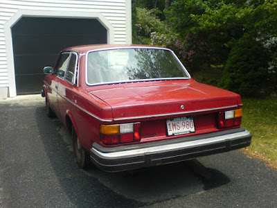

The car is a 1979 242DL. I bought it in December of 2007 from the original owner. The car had been sitting in his Connecticut garage for the last 10 years, so it was purchased as non-running for $500. For a lifetime New England car it had a surprisingly small amount of rust (along with 120'000 miles). After a nightmarish day of trailering it home I put fresh gas in it, cranked it for about 60 seconds, and it fired up. Granted, it ran like **** on three cylinders, but it ran. Here's what it looked like the day I got it home:
And here's how it sounded:

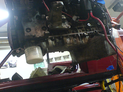

When I initially checked out the car it seemed like it was decent mechanical condition for what it was, but as I started tearing in to it I realized the previous owner was a lying moron with no regard for workmanship or safety. Both buttcheeks were 100% fiberglass; all the factory bullet fuses had been replaced with Radioshack 30A glass fuses; the sheetmetal in the trunk around the sender unit had been sliced to **** with a pair of tin snips; the stereo wiring was an electrical fire waiting to happen; and the advertised "brand new fuel system" consisted of a dead in-tank pump, dead sender, swiss cheese fuel tank, and rusted out hard lines.

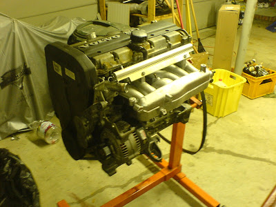

After a quick interior swap/refresh I put the car aside and started working on the engine.

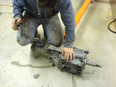

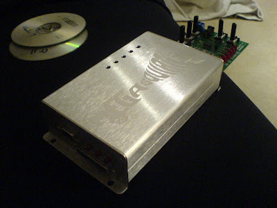

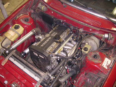

Take a megasquirt,
a T5 World Class,
shortened 960 pan,

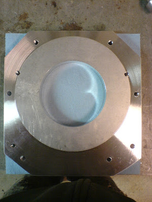

transmission adapter plate,
and some other fun parts, along with 30 straight 12 hour days (for both my brother and I), and you end up with something like this:
This is obviously a somewhat abridged history, but I'm sure you get the idea.

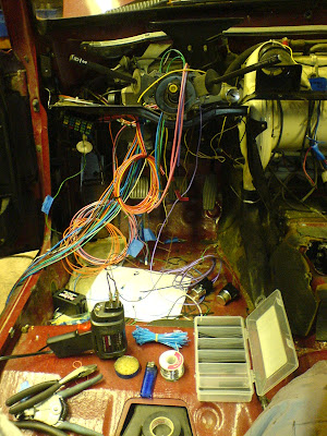

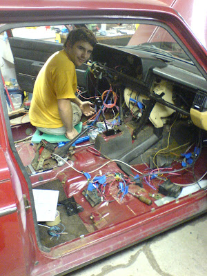

While chasing an elusive electrical gremlin I decided the old harness needed to go. After $160 on an eBay universal harness and four solid days of work, my brother and I had a brand new electrical system, complete with all 850 solid state relays for headlights and flashers.

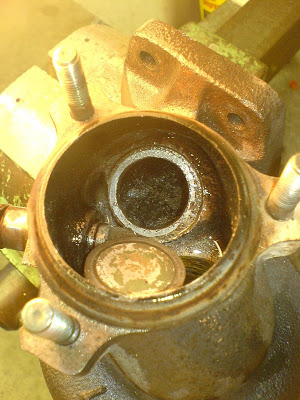

I was having vicious boost creep issues, so I pulled the turbo and ported the wastegate:

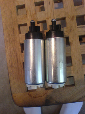

The Walbro 255lph pump I had bought turned out to be a cheap knock-off when it outright failed one day. I was forced to buy a new one, but at least I knew this one was real. Can you spot the fake?

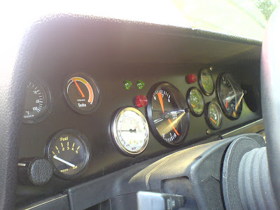

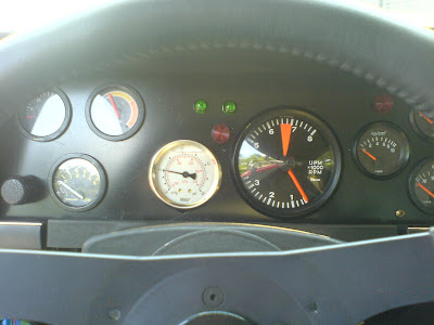

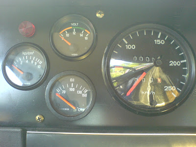

Made a new dashplate using 240 gauges, Porsche 924 gauges, and a glycerin filled industrial compound pressure gauge (for boost):

x Megasquirt V3 PCB running the latest Megasquirt'n'Spark-Extra firmware

x Volvo branded Momo Alpine steering wheel
x 250km/h speedo and 8k rpm tach from a European spec. Porsche 924
x Industrial glycerin filled compound pressure gauge (accurate to within 1%)
x VDO oil pressure, fuel pressure, oil temp, coolant temp, fuel level,
battery voltage, exhaust backpressure, and exterior temp gauges

186.2dB huh? Doesn't the human head explode at 160dB?
How come you need such an accurate boost gauge?

EBR gauge??? HOW? Where'd you put it? What's it read at full boost? I've been dying to do that for years, I'll probably just use a regular pressure gauge and a looooong hose.
