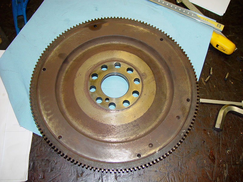

http://homepage.ntlworld.com/mj.slater2/101_0121.JPG
$300 .
muhahhahahhhahhaha !!!!!!!!!!!!!!!!!
