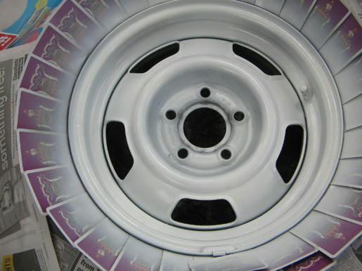

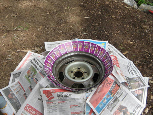

Then take your wheel to your painting area, which in my case turned out to be a patch of gravel. Now comes the weird part. Take your playing cards and wedge them between the rim and the tyre, making sure that they overlap slightly, like so.
After your sure that there in there nice and firmly with no gaps, lay newspaper around the rest of the tyre. Try and tuck it in under the cards as best you can, again making sure that there are no gaps.

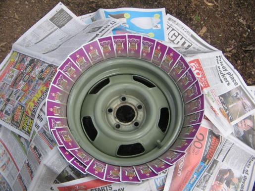

Once your ready, start spraying the coat of primer on. Once everything is covered, go have lunch. Your wheel should now look something like this.
Now shoot it with a coat of colour. Go easy as the colour is more prone to running, as I found out .
Now wait half an hour and do another coat. Your wheel should new look like this.

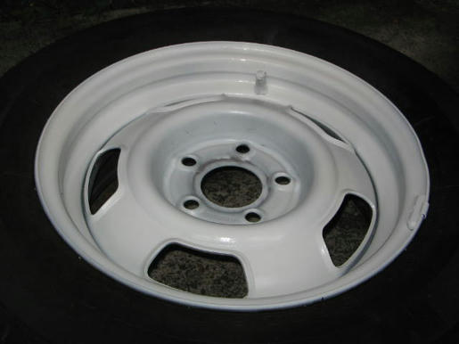

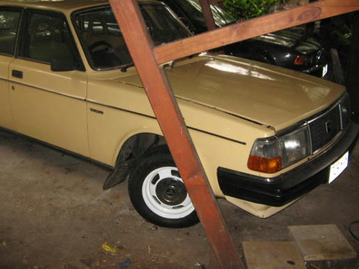

Heres the finished product. So far Ive only done the first 2 wheels, so I'll put up more full car pics tomorrow when Im done.
Its a little too pimptastic for my tastes, but its better than before . Not bad for a total sum of $40.

Thanks. Believe it or not I got the idea from a civic forum. The cards are really the only option because tape doesnt stick to the tyre. Im putting some clear on today because I have to take the fronts back off again to paint the calipers.
Edit: Got all the wheels on today. Looks AWESOME.
