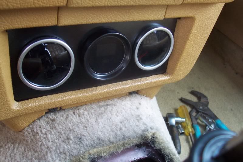

getting my refund from the struts now and ill order them from fcp. I ordered firewall braces for my car FINALLY! im so stoked. and I got my new voltmeter in!!

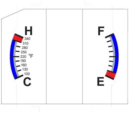

I havent figured it out yet but as soon as i do i am ordering new gauge backgrounds. this is what it will look like

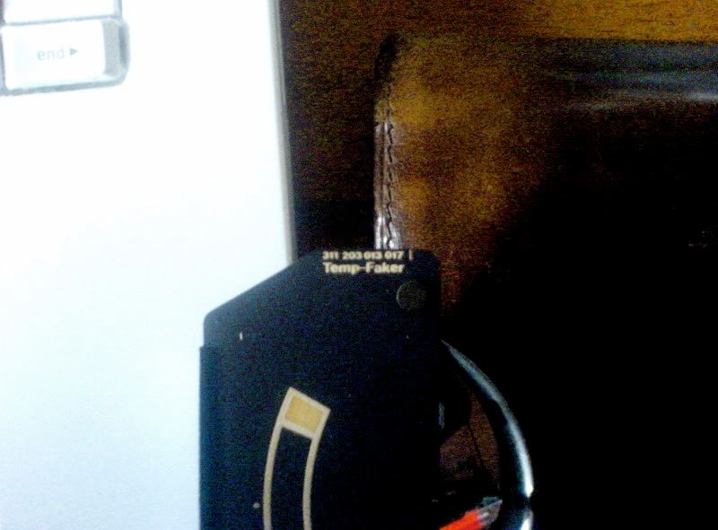

You are aware that if you have not bypassed the temperature compensation board in the cluster, that the reading you see on the stock temp gauge is not the actual temperature of the coolant, right?

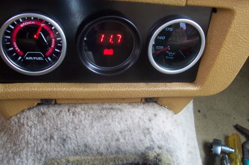

You reset the odometer???

I just noticed, your voltage is really low (I'm assuming your engine is not on).

ya engine isnt on and yes i did reset it.

There's a compensator board that is in your instrument cluster that is designed to decieve you of the coolant temp. Take that compensator board out and jump the first and third lead together. That will give you the ACTUAL temperature of your coolant.

Okay this is what you do.
1. Take your instrument cluster completely out
2. Unscrew the screws on the back of the cluster so that you can remove the circuit board and gauges in one piece.
3. There will be the compensation board sitting under the water and fuel gauges. It is about 4 inches long and held in by two clips on each side.
4. Once you have take that out you will see 4 leads sticking out of the circuit board.
5. Get a piece of wire and solder leads 1 and 3 together.
6. Reassemble.

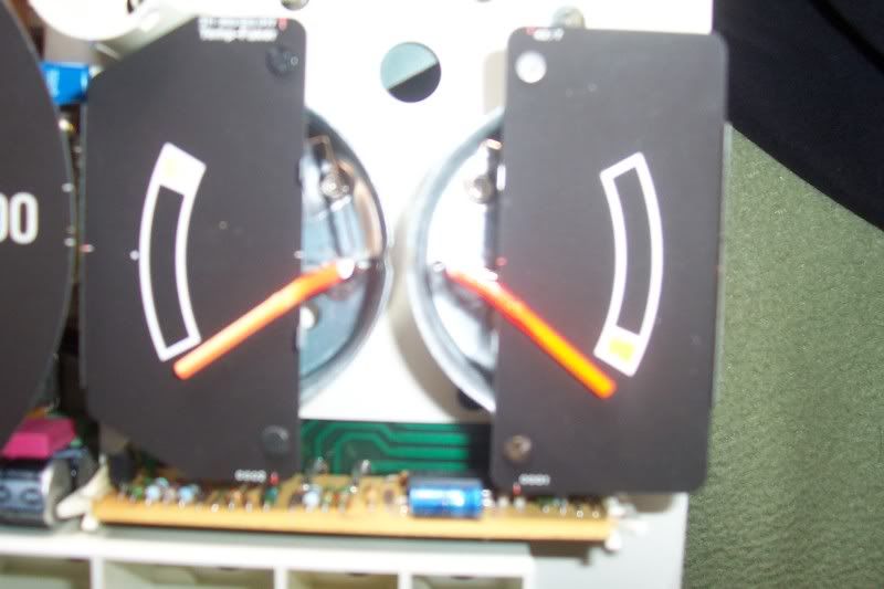

what do i do from here

From here, go back and read the damn STEP BY STEP directions that were already posted for you.
