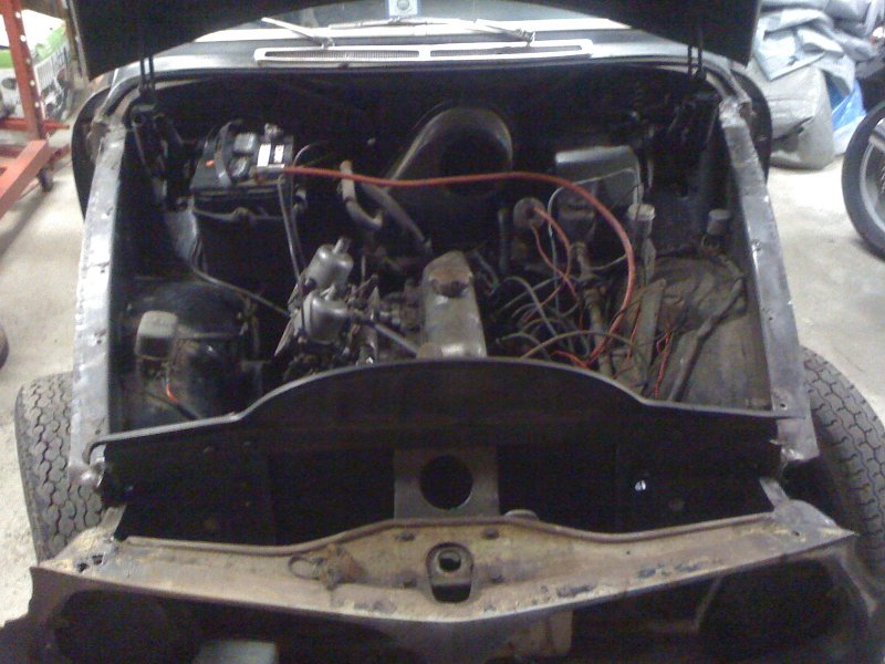

To start I bought this car in early 2007 for something like $998 on ebay. It sat at my parents until 2009 then sat at knoxmotorsports until May of 2010, Lawrence did a full check out of the car for me and was hanging out to it until I decided what route to go on the restoration.
I bought a house in April 2010 with a large Garage, so the 122 got a nice home in the garage now .

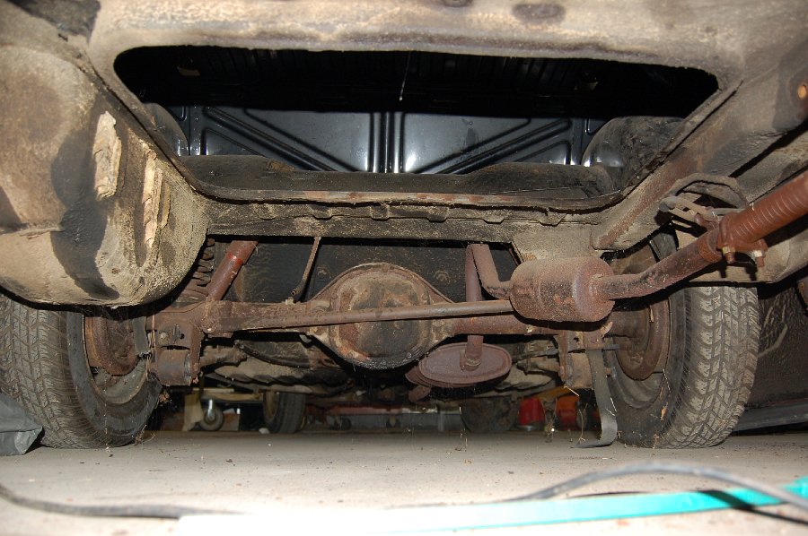

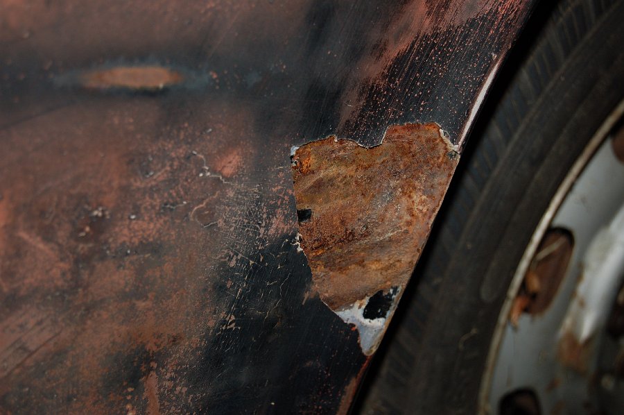

The car does have a bit of rust but nothing major. I just need to weld up a few things like front floor pans. Not a big deal though, considering I have been a sheet metal mechanic/welder for quite a few years now.
I still don't know exactly where I am going to end up with the car but for starters I am pulling the car apart and fixing everything on it. I want to keep the b18 in it running well but Lawrence @ knoxmotorsports is going to help me build a s40 1.8t motor to put in it. I might end up restoring this one and buying another 122 body and then putting the s40 in that, but like I said I am not 100% sure where this 122 will end up.

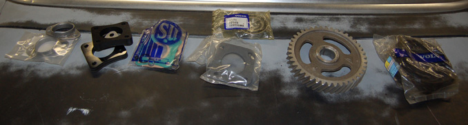

I have a bunch of cool parts for it including some new ones from the UK a few years back.
ceramic coated Phenolic spacers, stub stacks, and gaskets for the SU Carbs. Aluminum timing gear, New driveshaft bearing (which Moores volvo actually have in stock a few years back).
The SU carb stuff I got from http://aptfast.com/ it took a little while for them to get it from the UK but worth it.

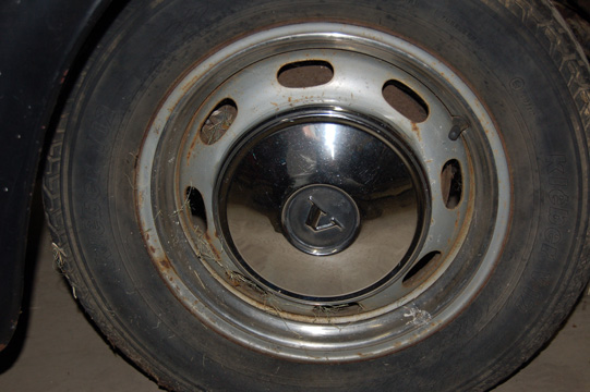

I picked up 4 mint hubcaps at one of the dyno meets

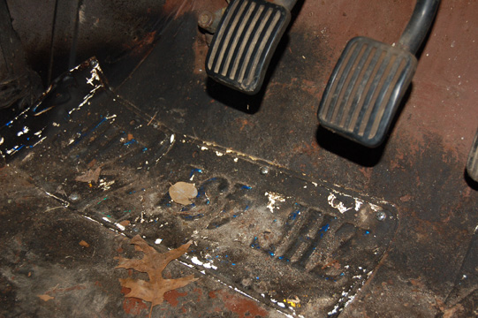

gotta love the license plate floor pans... honestly put some carpet down and no one would know. It's a great cheap fix but I'm a welder, so I will fix it right.

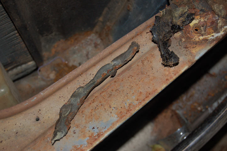

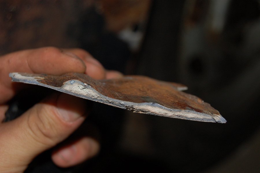

Not too sure what this goop is but it was used all over the car to seal metal that buts together. It did a great job of protecting most of it from rust. Any one have the answer?

I believe that's butyl, seen here:

looks like you are right Sir Psycho... it looks to be Butyl Rubber. Wonder if I should use it again. It seems to have held up over the years.

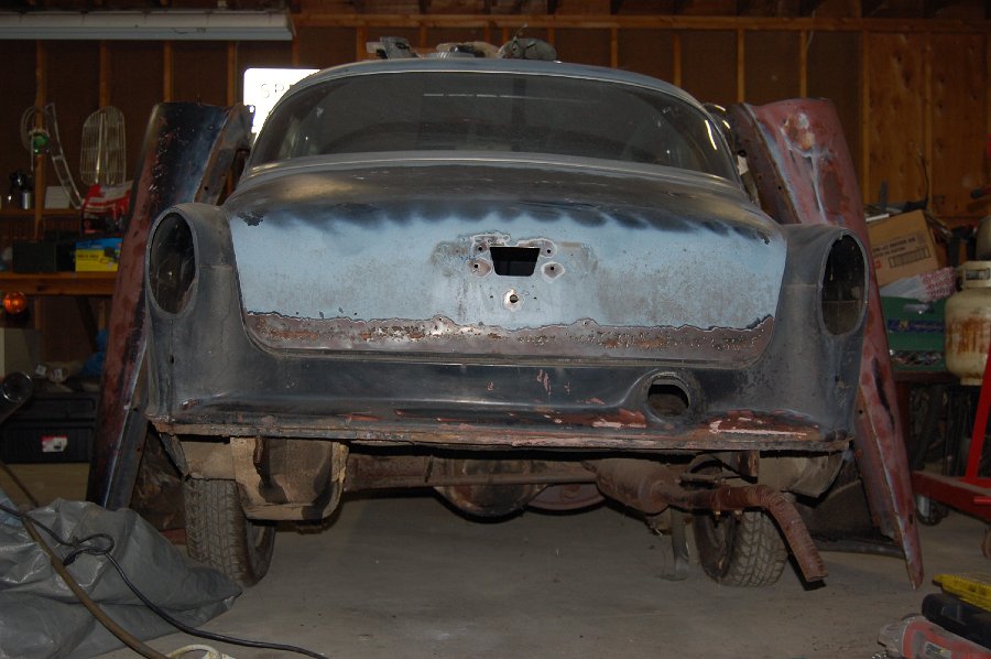

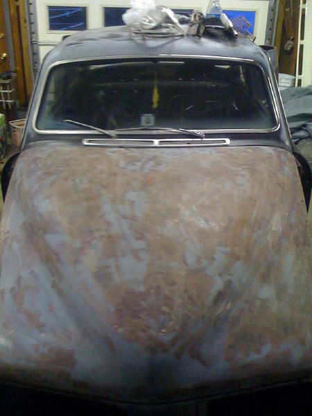

Both fenders are off now and the goo has been scraped off, I also wire wheeled any surface rust off and cleaned the area. I am just going to keep pulling parts off piece by piece and strip it down to the bare metal. I want to paint it the original code "19" BLACK. The Bumpers are in good condition I just need to pull them off and have them re-plated.
If anyone has good painting advice let me know. Would an enamel be better than a normal base coat clear coat?

I would suggest basecoat clearcoat paint. It it much better in all ways.
Its old school seam sealer. It never really wears out, but the newer seam sealer products are much better at keeping the water out. You just brush it on. The older stuff is still available at parts stores as well. Its just a PITA to install.

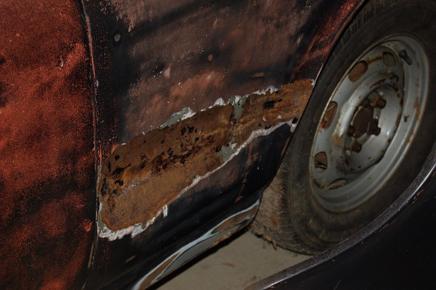

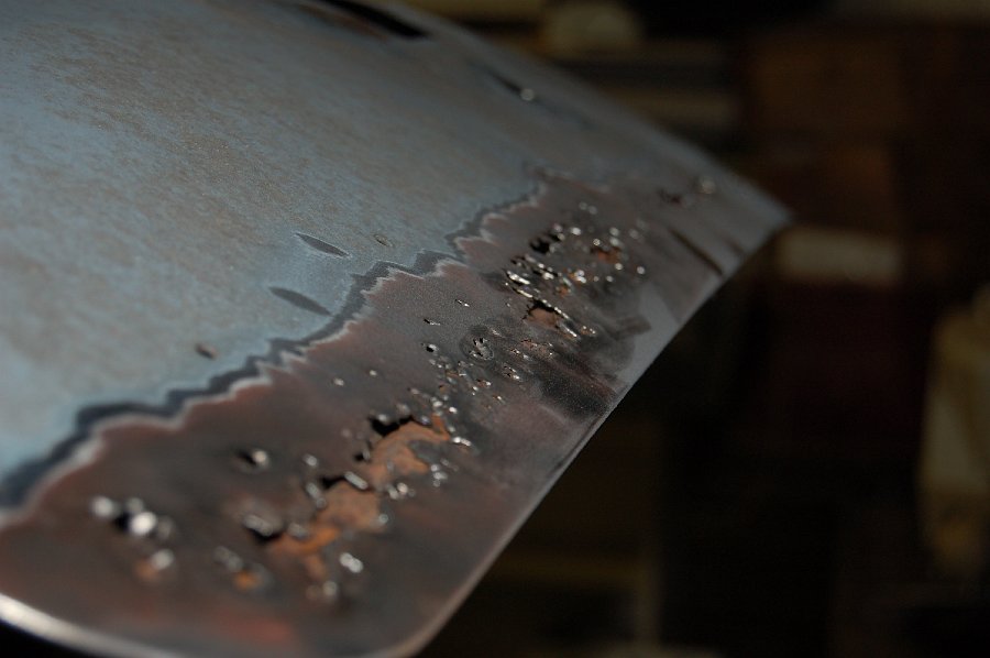

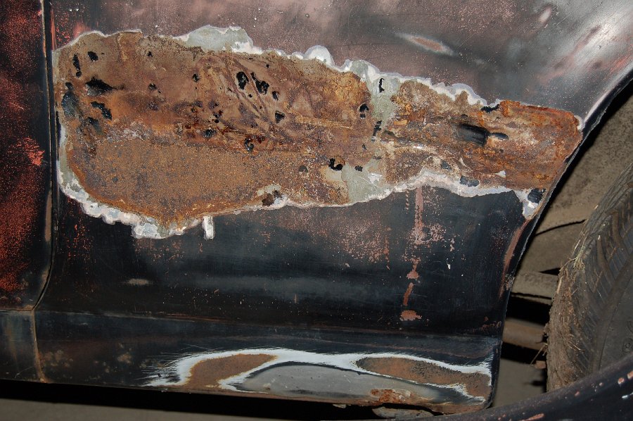

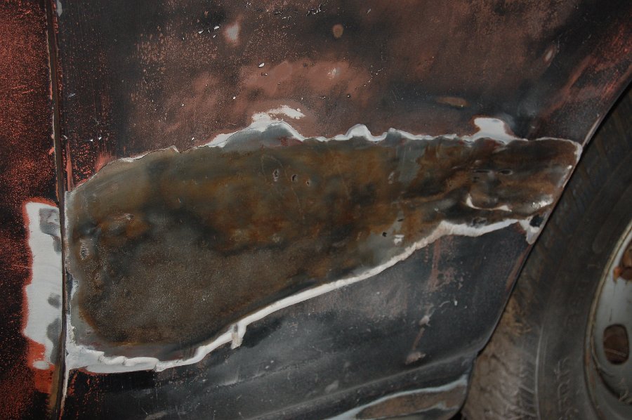

Pulled the tail lights out, the license plate light/latch and the bumper off the car tonight.
The bumper was bent and I am going to need to buy a new one.

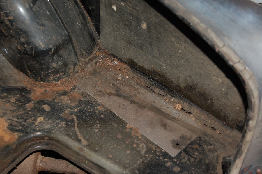

stripped the paint where there was rust... I will eventually cut out the rusted areas and stitch in new sheet metal
LOOK AT THE "PEASHOOTER" Exhaust ;) crazy thing is when it runs it has no leaks!!

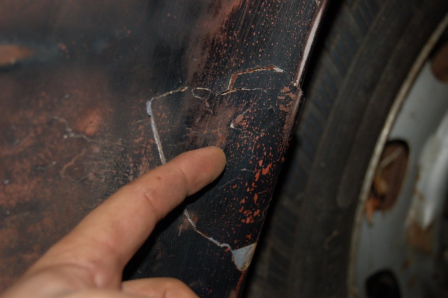

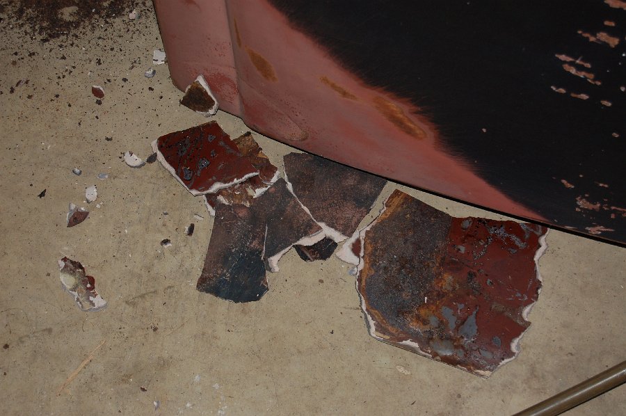

Yup it's bondo starting to crack
...and turns into this
...and then this
No worries though I cleaned it up and will soon work it out.

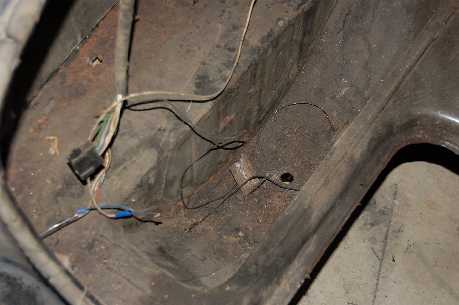

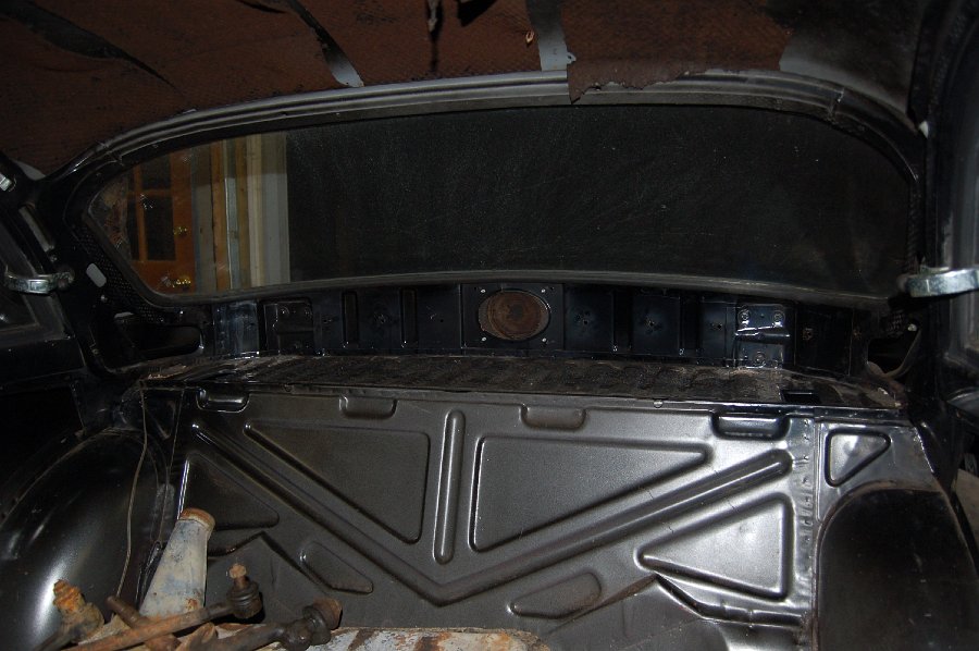

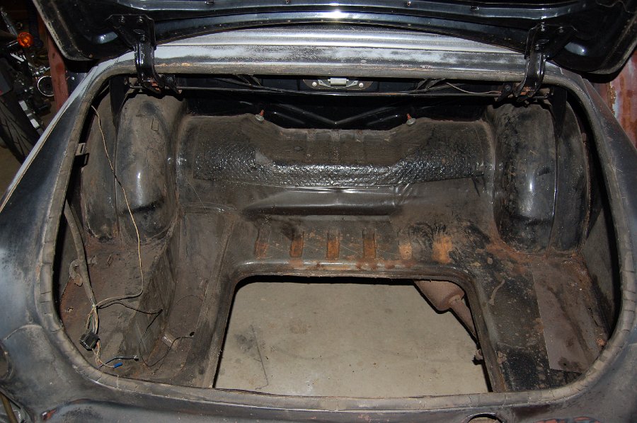

Trunk is pretty clean, not much rust. I took the gas tank out 3 years ago because it has a leak in it that I will have to fix... although I might just build my own aluminum one. I use a Large boat gas tank to run the car when I want to drive it.
YEAAAA MAN, bumping the jams in the single speaker haha

It's been a while since I touched the 122 but I started organizing parts yesterday and bought one of my final pieces for the restore last week. I am hoping to get some time in the garage next week. So far 4 tractors and the 244 have had me busy for a while. More
Photos to come soon.
Btw the 66 4 door I brought home in the above photo is now deemed my donor car for some parts at least. It was too far gone really to try and restore.

This section needs to be cut out. As you can see above, a bondo like material was caked over it. I'm talking with Paul here on TB about getting some sections of his doner cars. I want to take the car down to bare metal all the way around and start front scratch. That is what I will be doing soon here. Heck I may even try and strip some more tonight.
The rear trunk as you can see in photos above is rusted pretty good and the trunk, aka "boot" for you Brits, off the 66' is in good condition. I will swap that soon.
I also need to send the B20 to the machine shop and start a build on it.
I need to have a Volvo work party and get some help for beer and Pizza! Who's in ?
I need you guys to keep me motivated with ideas and positive reinforcement lol.
240 JAH is offline   Reply With Quote

Don't cut that area out, panel beat it. Look up Wray Schelin shrinking disk and get a slapper and a decent dolly.
