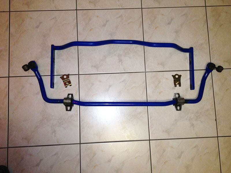

Is that a trick question? Measure the diameter of the bar. If a 24mm wrench doesn't fit the rear bar...
No it's not a trick..
Didn't measure but it looks like the rear bar is larger in diameter compared to the front bar.
Added to that the rear bar's functioning is somewhat different from a "standard" bar so I thought maybe the bar is hollow and iPD used the 22 mm naming just as a sort of force indicator.

weigh it and check the density
I would also think you could probably tap on the rear bar with a hammer and hear if its solid or tubular.

It's solid if it's one of ours. All our bars are solid. Johann, I'm guessing you got that set from European Tuning, because we have plenty of those kits in stock...

This is a used set. Don't know if it came from ET.
Ordered a new set 25/22 early December from another supplier in the Netherlands. They had 25/25 in stock but the 25/22 was backordered.

Now I know where the swaybars went, you beat me to them. Great ad to this project.

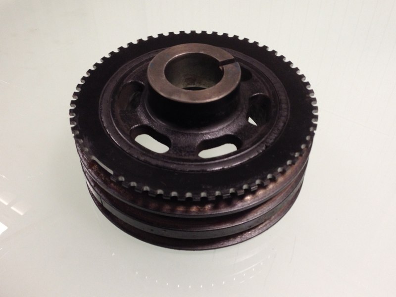

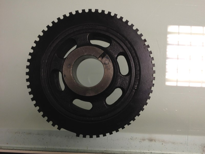

A trigger wheel attempt,

oh snap, you gonna get that thing rebalanced?
You might have some issues wit hteh trigger wheel being rubber damped. Have you considered running a CAS DSM adapter? Yoshifab makes a slick unit.

not using the 60-2 on the flywheel of the B234? The redblock harmonic balancers arent nearly as wear-resistant as the whiteblock ones.
rest: very nice, car looks beautiful. looking forward to see more updates!
Often a point for concern yes but this pulley appears to be in good shape. Only needs to drive the alternator and water pump. For now I don't have any concerns.
There's hardly any room behind the engine. Will need to make something at the cam later on to run the engine sequential.
Not at the moment no. Used a B21E flywheel and also the M46 gearbox which isn't prepared for a crank sensor. Because of this I was forced to make something at the front of the engine.
Time will tell. Like I said it appears solid given the way I bolted it to the mill table.

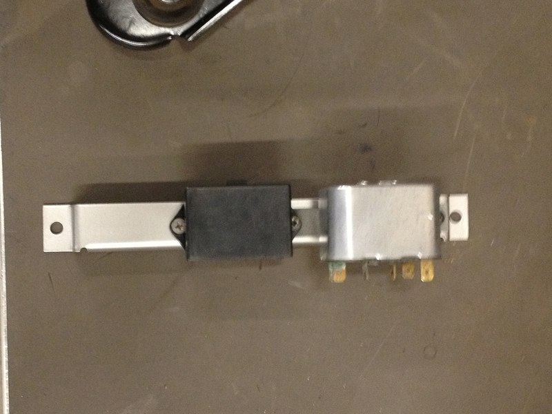

Decided to not use the B21E K-Jet fuel system. This because it has the fuel filter placed above the firewall in the engine bay which I don't like.
Visited the wreck yard today and pulled a pump and filter bracket plus everything on to from a newer 240 model. Cleaned and painted it and installed a new pump I already had in stock.
Also pulled the complete fuel feed line from the wrecker because it has the proper length and connections.
While at it I also took the bar holding the light relay from this car because it was in better shape than the one which came with the 242.
In the mean time work on the EMS is slowly progressing.
Loom is near finished apart from some connectors. Injection and coolant connectors are already in place
Also bought a nice fuse-relay box,
Exhaust is installed using a stock flame pipe and a 2.5" Simons exhaust system. Need to weld in an O2 bung still.
