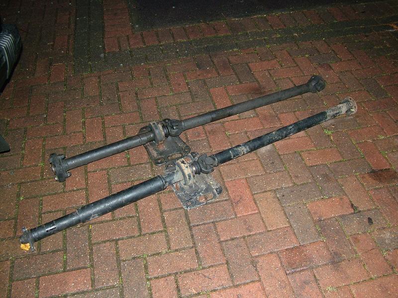

Here's some pics of the 2 boxes side by side. (M90 on left)
M46 in the background
Different propshafts. M90 is the Longer one.

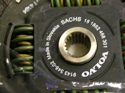

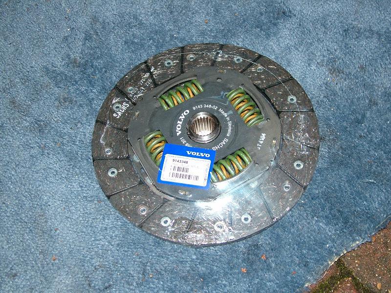

I used a 940 Turbo Diesel M90 Equipped Friction Plate to get correct Splines(disc is same diameter as M46 One), used the stock M46 pressure plate, and then just used the standard release bearing that came with the m90.
Guessing the other numbers are Sachs Part Numbers , the volvo part number is 9143348
