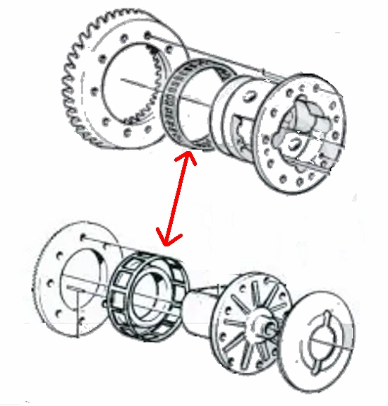

Generally, a non-turbo, non-ABS diff will have a 12-slot tone ring.
Add ABS, the ring goes to 48 slots.
(I hear one year even had 96!)
48 / 12 = 4
50KM * 4 = 200KM
Looks like your 12-slot-programmed speedo (1986 745) is getting too many pulses from your (apparently) 48-slot diff.
You need either:
1 - Different diff with 12 slots to match the speedo.
2 - Different speedo to match the current diff.
3 - Modify the tone ring from 48 to 12 slots.
4 - Replace the tone ring with a 12-slot.
