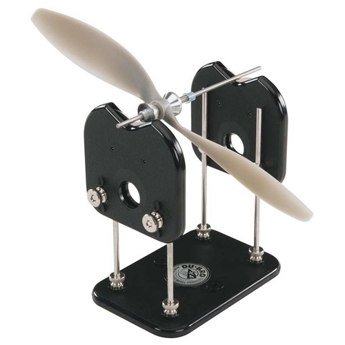

Build yourself your own balancer by copying how RC people balance their propellers:
If off balance, pulley will rotate. Shave/grind/drill a bit on the heavy side and then repeat until no more rolling.
